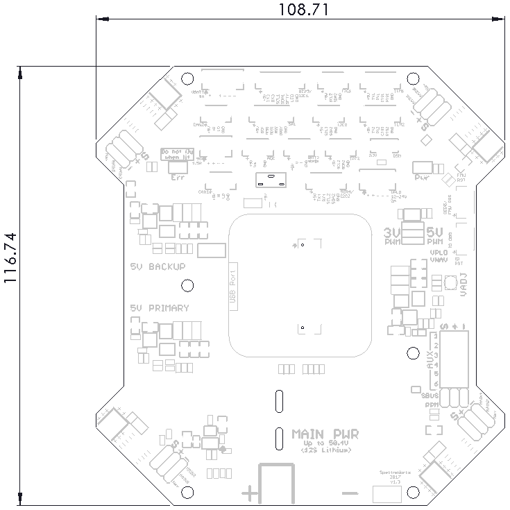

### Outer Dimensions
![](http://docs.spektreworks.com/assets/images/carrier_board_dimensions.png)

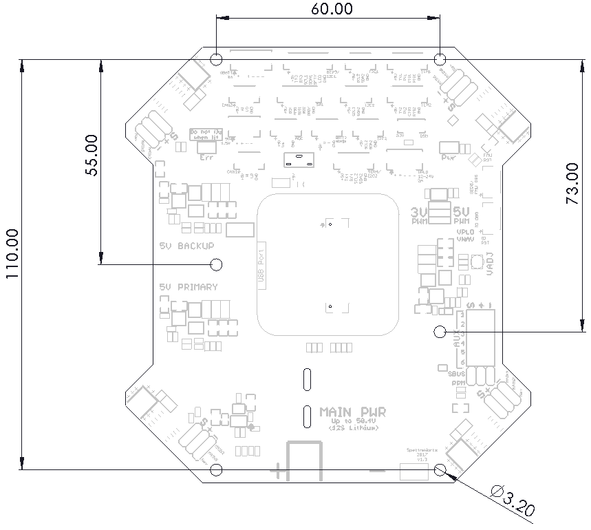

### Mounting Hole Locations
![](http://docs.spektreworks.com/assets/images/carrier_board_holes.png)
