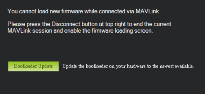

{% hint style="info" %}
Firmware cannot be installed when The Cube is connected to Mission Planner.
{% endhint %}
<figure><img src="/files/uzlvDBT3cmuDo815KUTI" alt="" width="524"><figcaption></figcaption></figure>

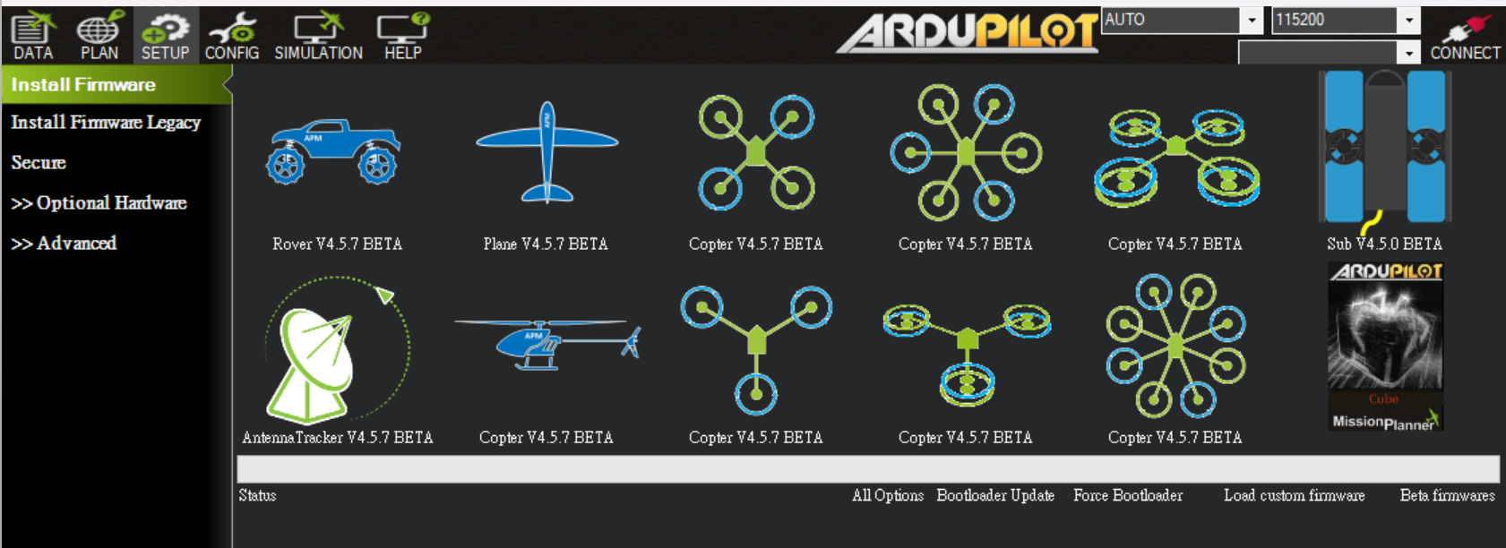

1. Open Mission Planner.
2. Click **Setup** -> **Install Firmware**.
3. Select **AUTO** or a specific port of The Cube.&#x20;
4. Set the Baud rate to 115200.&#x20;
5. Select the type of platform and firmware to install from the drop-down menu.&#x20;
6. Click **Upload Firmware**.&#x20;
<figure><img src="/files/qjmrLVZlOL9SAouQRjhq" alt=""><figcaption></figcaption></figure>
<figure><img src="/files/fttGiEaJ00Tsk60aqYL1" alt=""><figcaption></figcaption></figure>
