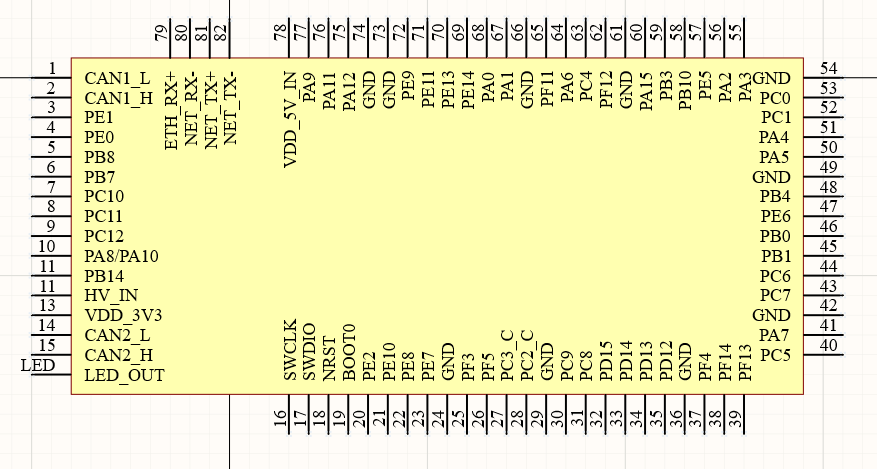

## CubeNode Footprint SCHLIB
<figure><img src="https://3175993181-files.gitbook.io/~/files/v0/b/gitbook-x-prod.appspot.com/o/spaces%2F-LUhw7cdLeWVORgnTA3i%2Fuploads%2FOxpueAj2gN5pMqEJ0n9c%2FV3_Footprint.png?alt=media&amp;token=fee1fc41-bfc4-4da0-8ae9-543910160865" alt=""><figcaption></figcaption></figure>
<figure><img src="https://3175993181-files.gitbook.io/~/files/v0/b/gitbook-x-prod.appspot.com/o/spaces%2F-LUhw7cdLeWVORgnTA3i%2Fuploads%2F0McAX4SrwbA23ptUJ5Nj%2FV4_Footprint.png?alt=media&amp;token=ce6a6def-910d-4e06-8fb7-dacde8fad096" alt=""><figcaption></figcaption></figure>
